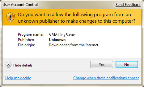

As of 6th May 2011, we decided to make our applications UAC setting to HighestAvailable.
This means that if you are an Administrator then you will be prompted every time the software starts, this is so that setting files which affect all users can be changed:
If you are standard user account then the software will run normally, but certain features will be limited.

Admin account:
UAC warning appears
