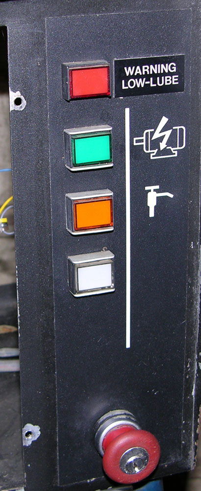

Can anyone tell me the purpose of the grey on/off push button please?
This is the cabinet containing the Fagor control on my Easiturn, Thanks...

I presume it is a Axis Limit Overide Switch.
Re: 3-Phase Easiturn 3
thanks Martin...
