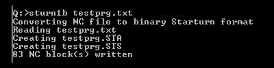

And after all that ....... Mr Magoo finds a DOS utility which takes G-Code text files and creates an STA and a STS file :roll:
Here it is: :D
Shows the starturn STA file creator running from a DOS command prompt (in XP)
STURN1B.zip
Contains the sturn1b.exe and an example G code program.
Just type sturn1b testprg.txt to convert the gcode into STA format
(7.53 KiB) Downloaded 1479 times

i have run in command prompt but, cannot read nc file is displayed where it should have converted blocks
can someone tell me what i am doing wrong
