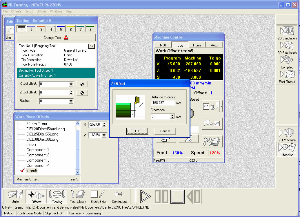

We are doing controlled assessment today and when we have come to set the Z datum on the workpiece offset it will not reset to zero.
We have rebooted the pc and also turned the machine on and off numerous times but it will not work.
Please advise on how to overcome this problem.

This is the print screen I have taken when the Z workpiece offset was set to zero.
None of the datums were setting to zero.
Please advise

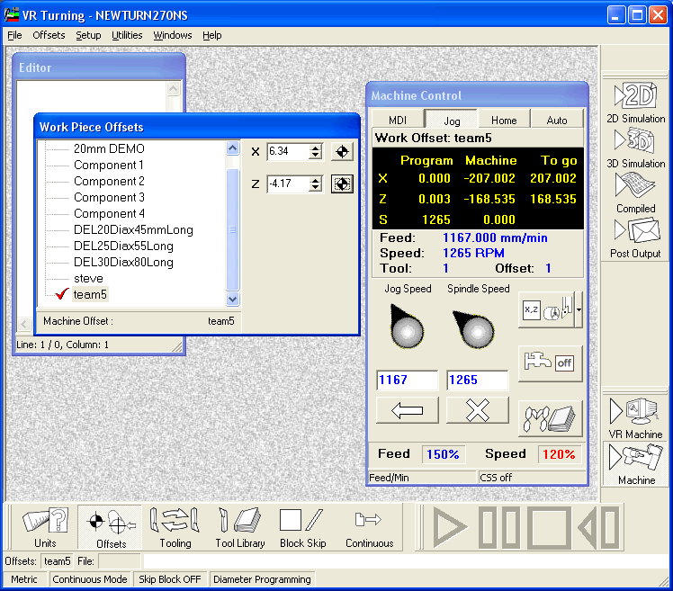

I've used your offset file and tooling file, moved to the same axes positions as your original screenshot, then created and activate a new set of workoffsets called team5 (to match your screenshot).
With tool 1, offset 1 active I press the datum button on the offsets page and can get the program display to zero no problem.
Have a look at my offset values generated: X6.34 and Z-4.17 - these look ok to me and that the workpiece is not very far from the piece you used to set the tool offsets.
I noticed that your workoffset values were X-213.85 and -169.67 - these look wrong as it would mean the datum position would become Z-334.04mm away from the home position - the Z travel is only -225mm :?
I wonder if you are putting values into the distance to origin editor (after you hit the datum button for X or Z)
For your original screenshot, that value should be something like Z-4.17 and a clearance of 0.00
