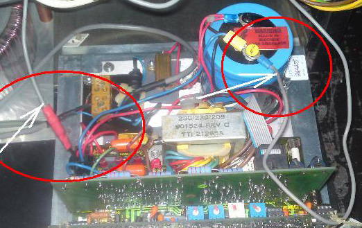

...I am trying to locate the ends of these two gray wires (white arrows) in the attatched image of the ORAC Inverter. Mine was delivered with these wires disconected and the motor will never start except if i make the conections the way they were done by the manufacturer. If anyone knows where these wires go and what they do, please help!
It seems one comes from the large filtering capacitor(power supply capacitor).
Is my machine missing a transformer or something? In a modified machine like mine I see these wires go to the secondary of a trnsformer but what it does or what voltage is present there I have no idea. Besides this transformer is not present on my machine.

Orac Inverter board.

I think theres an electronic lump bolted up by the back of spindle under the end cover that connects onto that

We used to fit what looked like a transformer in the end panel. I allways thought it was a choke for the spindle.

In our machine, those gray wires do go to a transformer/choke that is located inside the left side of the machine in the spindle compartment. The schematics we got from this board also showed this choke and wiring.

The grey wires do go to a choke, and although the inverter is a little slow to respond it works very well with good torque levels at low revs. The choke looks like a transformer with just two wires coming out of the top of it, and is usually located in the left hand end of the machine behind the headstock. There is a small relay that clicks in first before the spindle starts, and if the machine hasn't been used for a long while the motor can be a bit stubborn to start.

...thanks anyway! There is no choke here like the one described by you guys. It has been removed I dont know when/how.

One of the cables who's other end is missing on my machine is connected to a large electrolytic capacitor.Or it looks like a capacitor. It has no microfarads printed on that thing. It only shows voltage range.You can see that on the photo. My first post on top of this page.
