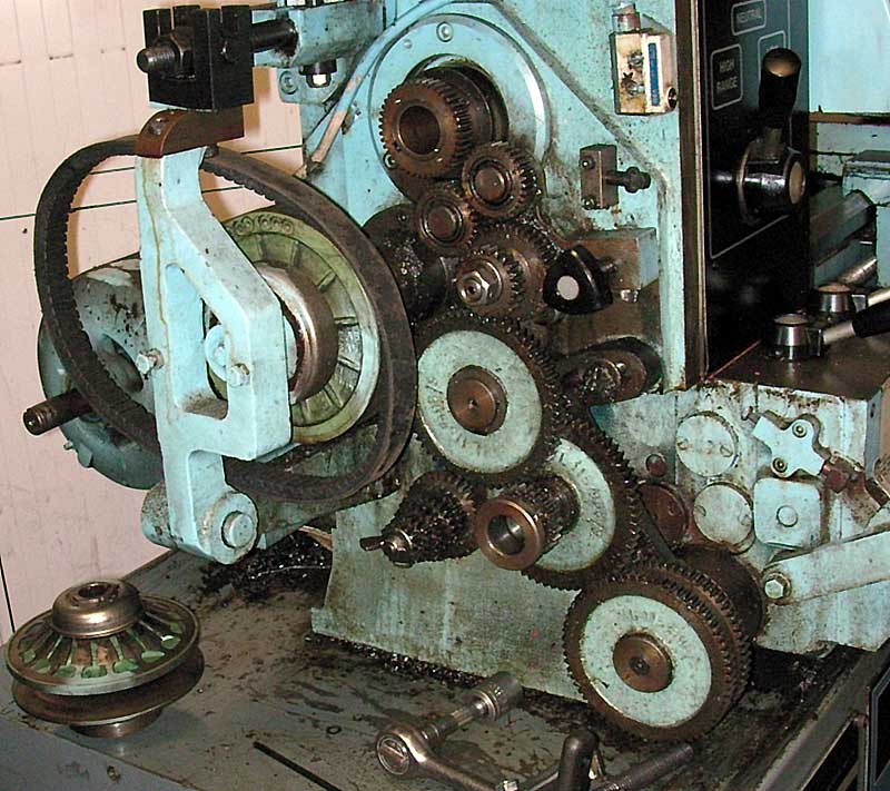

Here is what the end cluster of the gearchange looks like within the cabinet, for your reference. Your should be identical (except of course for the motor and pulleys).
