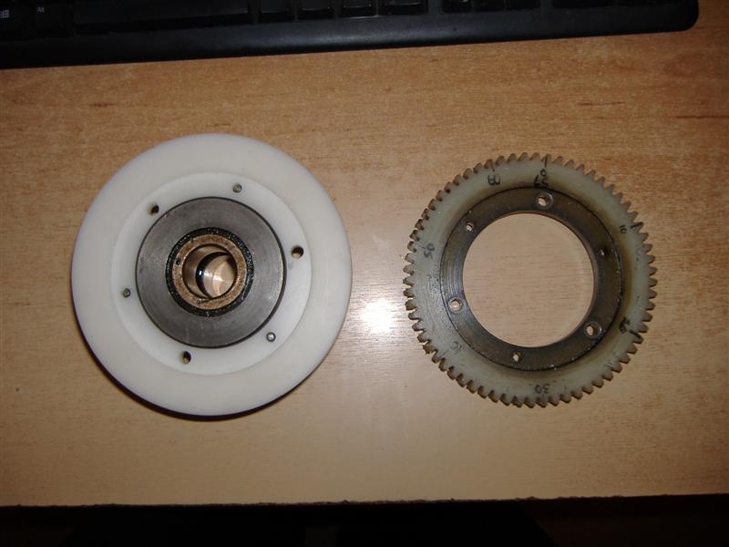

Well since my own gear is on it's way out and Rocboni's is missing a bunch of teeth, and neither of us want to pay £270 a piece I've decided to collaborate with him to make us both new gears. We're each buying our own material, Rocboni's paying for the involute cutter and I'm doing the work.
Here is the first blank finished to size and test-fitted to the hub from Rocboni's lathe. Having the parts in my hand made it a lot easier for me since I'm not an experienced machinist and found it easier than trying to visualize the work from the drawing, being able to test-fit the parts means that I could get a very nice fit too.

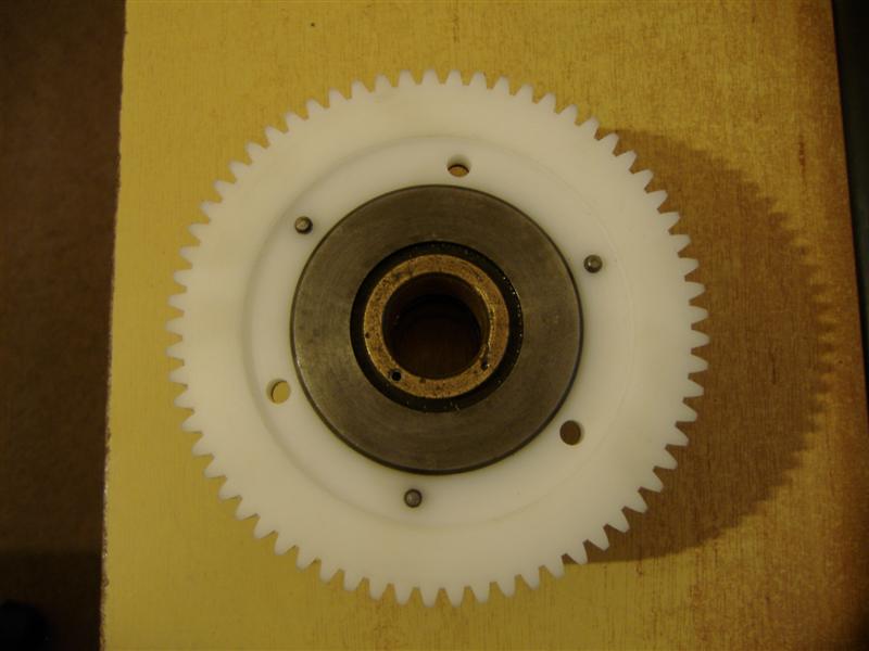

Id just like to say that my lathe is functional again, thanks to petes gear cutting skills, he made a very professionally job of cutting the gear.
thanks

I made the gear from Delrin Acetal, since that was the material specified as suitable in the quote I got from the gear company. It's a material that's commonly used for gears.
It was very satisfying to get a PM from Rocboni saying it fitted and ran well, since I had never cut a gear before this. I actually made a mistake indexing the very first one and ended up with a single under-sized tooth, so I bought some thicker material and made a pair as one then parted them to give one for me and one for Rocboni. Hopefully they will last another 25 years or more :)
