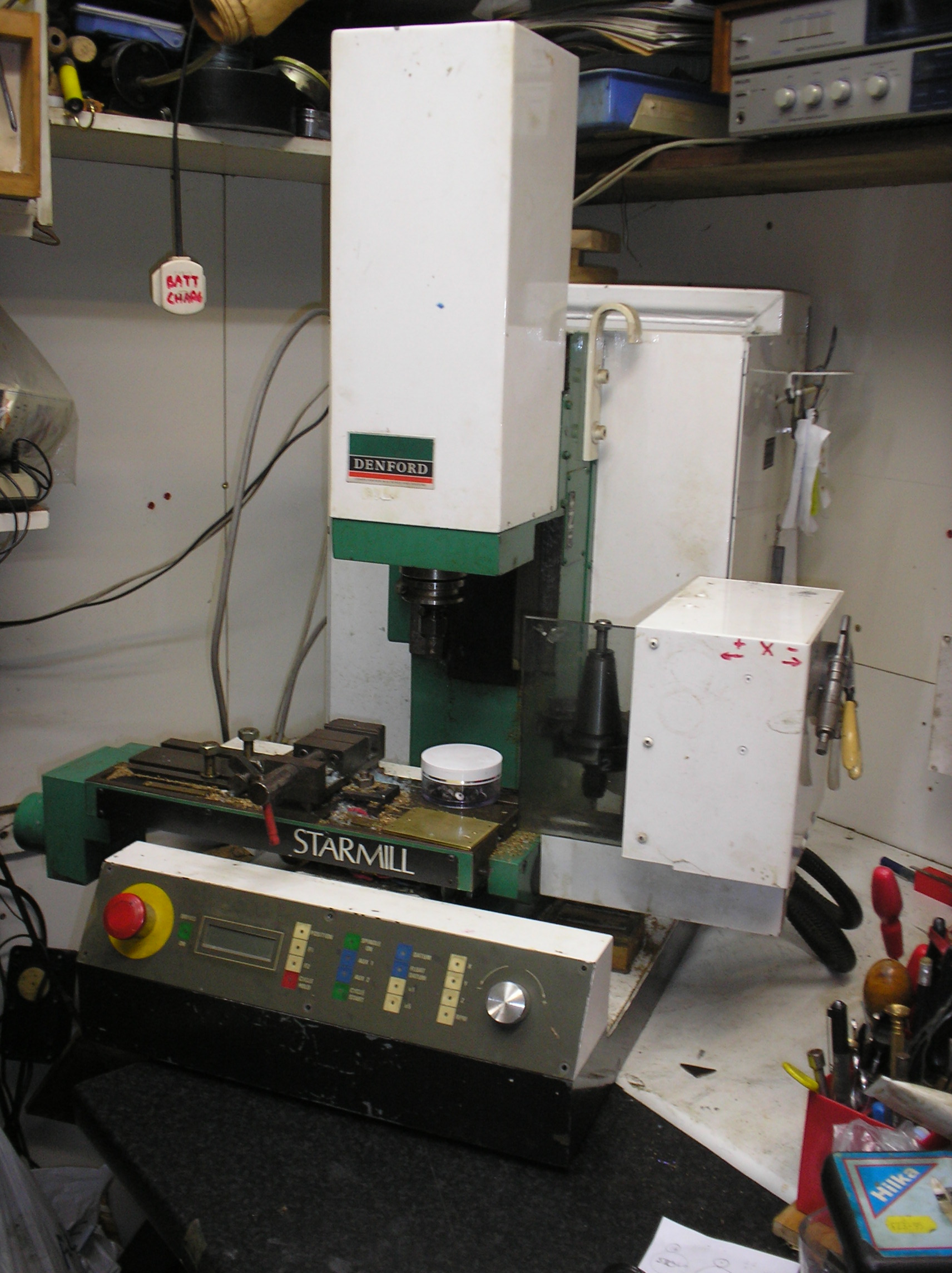

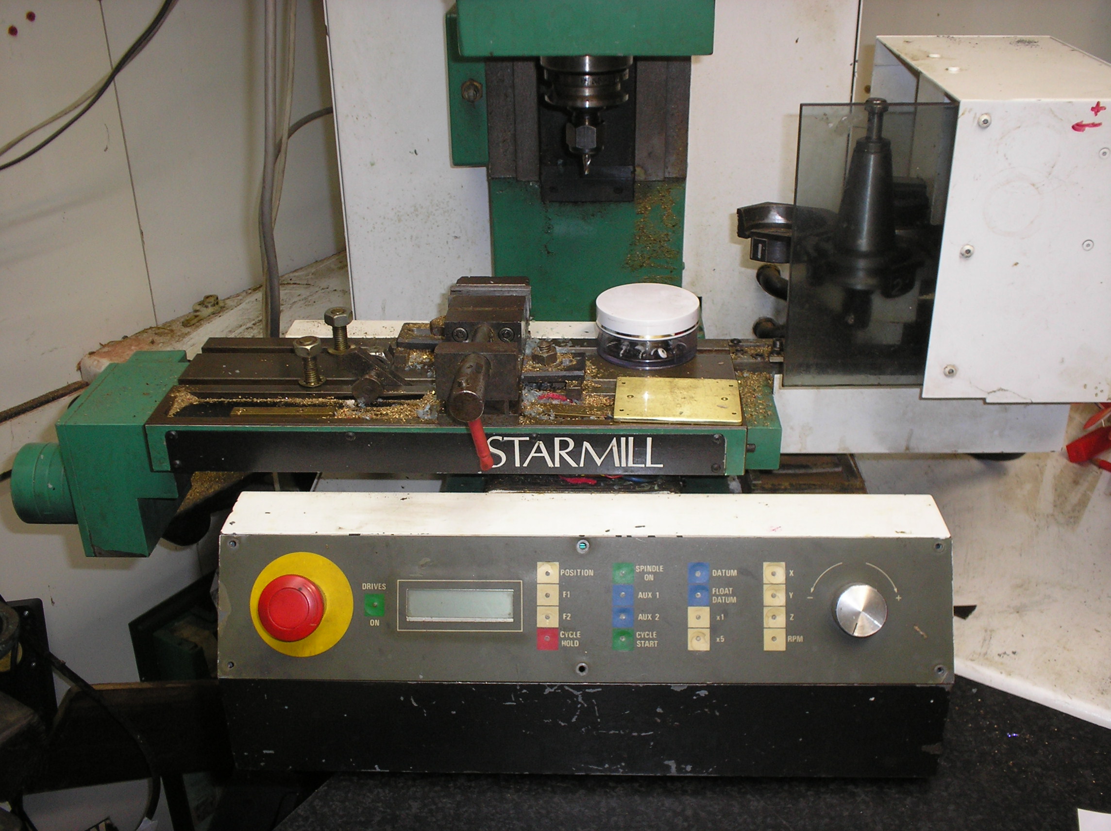

Right, here is the correct information. Disregard all previous woffle. ( Should have worked for ministry of disinformation, or the government) Year of manufacture- 1988 machine serial- 280361. control serial- 230288.
Control- 24v main motor Spindle- .3hp .22KW DC Ph. Thank you again. Phil.
starmill 001.jpg (734.11 KiB) Viewed 11844 times
Starmill front.jpg (672.97 KiB) Viewed 11844 times
Starmill front 2.jpg (665.49 KiB) Viewed 11844 times
