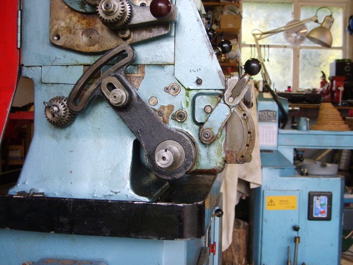

Firstly the serial number is 12914m and the leadscrew lever is on the headstock, and not on the top of the gearbox as others i have seen, so is this a very early version????.

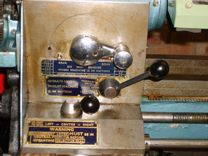

Secondly all the other machines i have seen seem to have 5 or 8 ranges on the dial gauge and lever, mine has 4!! so according to the transposed gearing table on the machine for cutting imperial threads, 7, 14, and 28 tpi requires both dial and lever to be set at 5. am i missing something here!!

Now the pics, please dont be too hard on me!!!!
Showing position of leadscrew lever
S6000643 (704 x 528).jpg (115.72 KiB) Viewed 16861 times
Screwcutting plate showing ratios
S6000642 (704 x 528).jpg (109.96 KiB) Viewed 16861 times

Finally the ratio plate again showing the 5 speed box!!
S6000652 (704 x 528).jpg (79.39 KiB) Viewed 16861 times

I'd not noticed before, but if you look on Tony Griffiths' Denford page, there is a picture of a gearbox machine with the feed / screwcutting selection lever on the headstock, like yours is. So clearly not a 'special', it must simply be an early model.
Regarding your 4 dial positions, I can only guess that the early metric gearboxes used "1/2" of an imperial gearbox (which have 8 positions). Compared to the 5-position metric gearboxes, you are only missing a couple of threads at the 'large' end of the standard pitches:7mm, 5.5mm, so I would not have thought that this is much of a limitation for most metric usage.
Now, it could be that the ratios in the 4-position metric box left awkward gaps when using imperial transposing gears - and another guess is that the tranposing set you have (with its special guard) was supplied later, after the introduction of the 5-position boxes.
To check out my theory, I would need to confirm what the end-drive gears are on your lathe, and especially how many teeth the stud gears have.

Well, this proved to be an interesting little exercise, with a few 'red herrings' to catch me out!
I have worked out what the gearbox ratios must be in the 4-position box, and revised my calculation sheet to include them - here.
Now for the catches:
1) The number of teeth on the stud gears A-D as marked on your metric plate are not the same as the ones you have marked A-D.
From my calculations, for the 4-position box as marked on the blue plate on your lathe, the stud gears should be:
A=24t, B=21t, C=27t, D=30t
You have the first 3 anyhow, and the 30t is only needed for 5mm, 2.5mm and 1.25mm pitches. In a way it makes sense for the 'old' A to be 24t, as this is the standard stud gear for the English boxes.
2) With your transposing set, you cannot cut 6.5, 7, 13, 14, 26 & 28 tpi - which substantiates my previous theory as to why the 5-position box was introduced.
Attached is the transposing table for what you can cut.
Please do a few tests to make sure I've got all my figures right, and let me know if anything is wrong.
