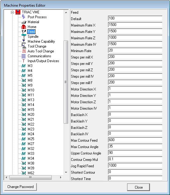

i have noticed in VR milling 5 machine settings there is an option under the feed section to add backlash values. is this enabled as playing with the figures dosent seem to make any difference.

The backlash parameters are inactive on this machine. They were specified in the setup for further use.
An error of 0.1mm is too large to correct you should inspect the machine and find where the error is coming from.
