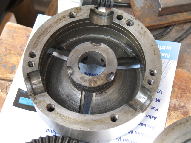

The back plate wouldn't fit the Denford, so I made one.
Bevel gears drive the scroll plate.
The back plate mounts on the back half of the chuck. The chuck is split along the centre line of the bevel gears. The join line is practically invisible (accurate machining)
The scroll is a dished spiral.
The scroll fits within a reasonably complex casting.
The Taylor chuck is bigger than the standard one, but not too big.

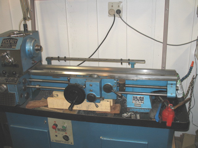

The dust gets into everything. I placed a magnet near the tool cutting edge to trap a lot of dust. I partially stripped the lathe down to clean the dust off (it is very abrasive when mixed with oil.

I stripped the lathe down to clean of the cast iron dust.
