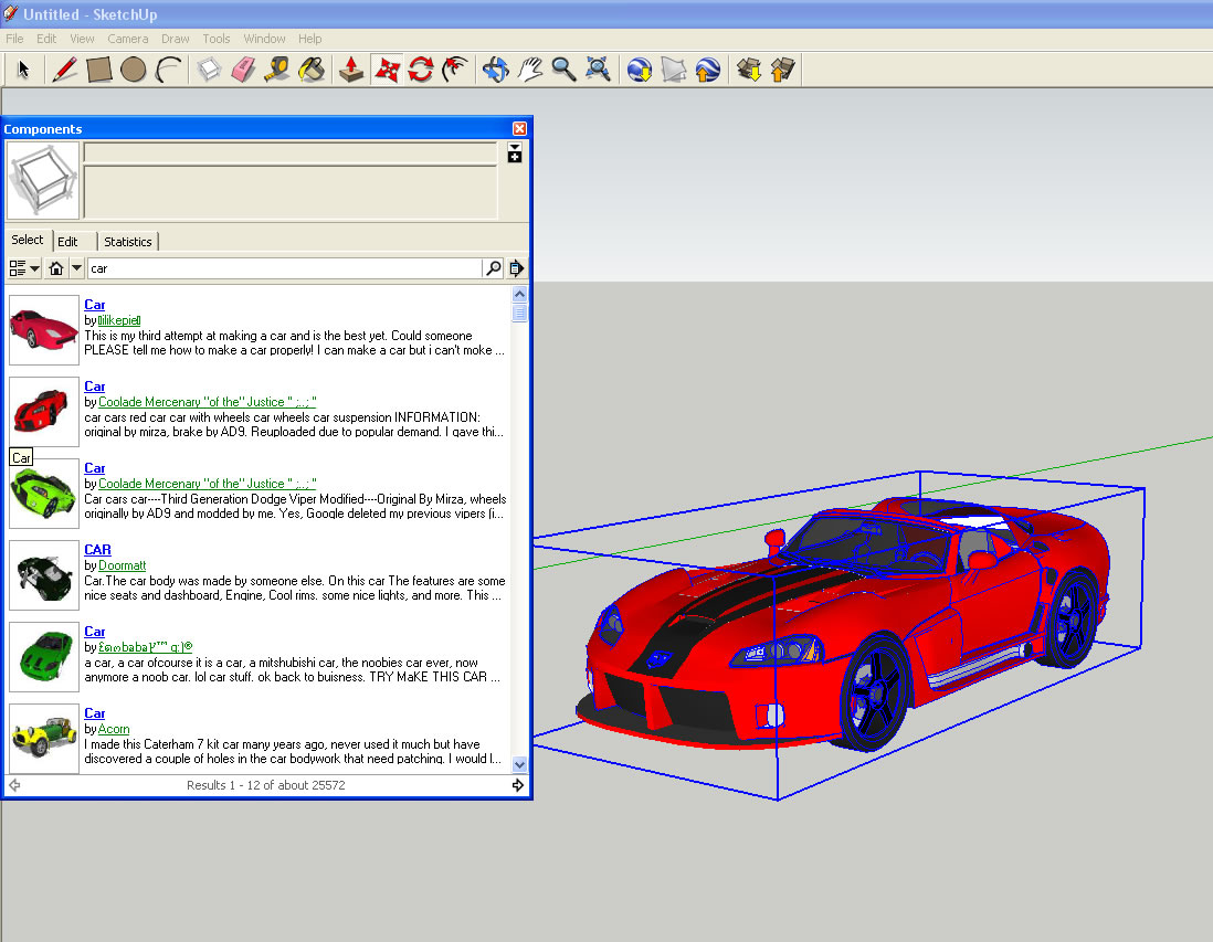

... Run SketchUp and have a browse through the masses of 3D models...

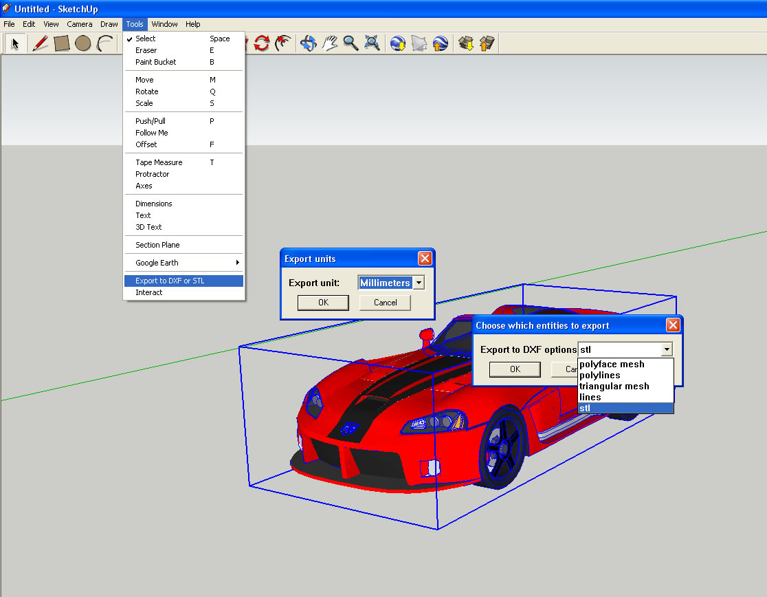

... select (highlight) the model and goto the Tools menu, select Export to DXF or STL and choose the .STL option when asked and save the file...

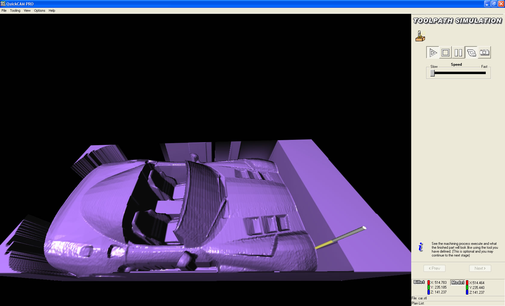

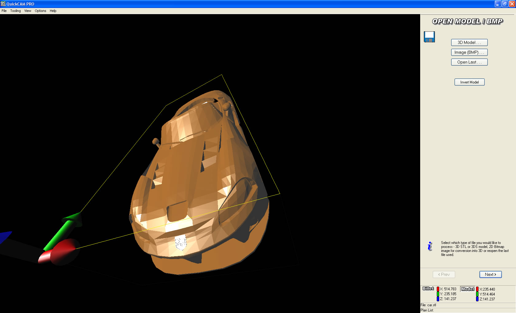

... load up the .stl file in QuickCAM 3D or QuickCAM Pro and create a CNC toolpath 8)
